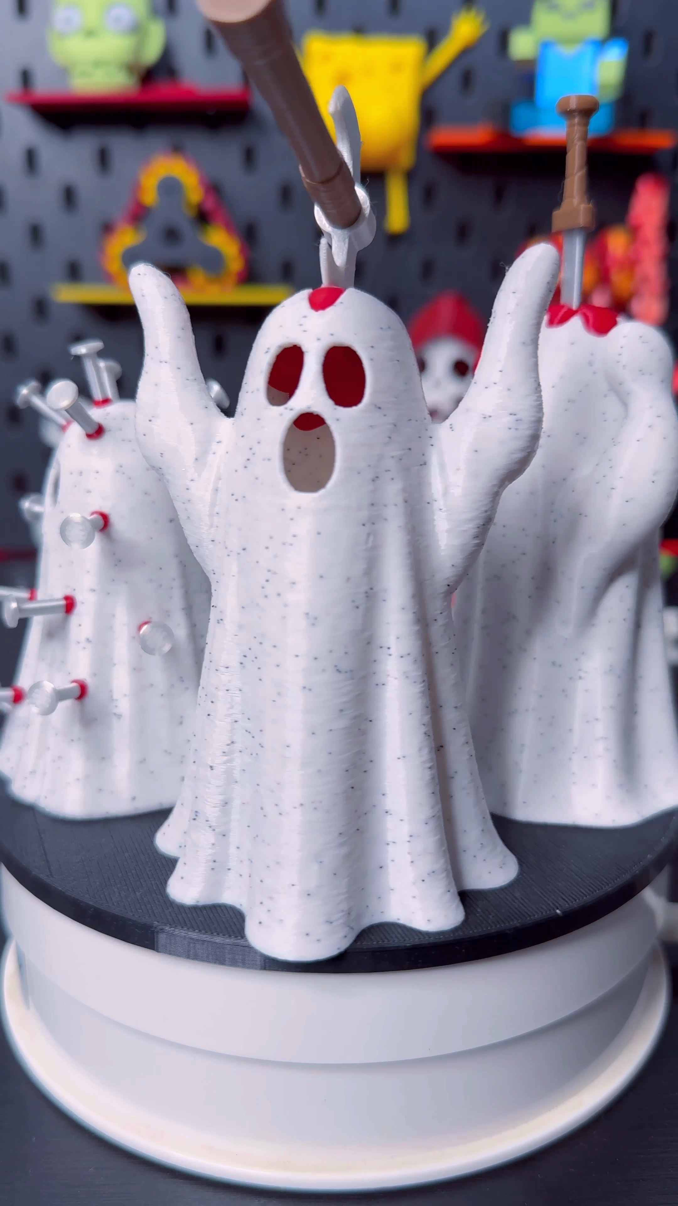

After the success of The Wounded Ghosts I knew I'll make another set so here are the 4 new members! As previously these are all multi-part models so no AMS or any other multicolor printer is needed here - Just a little glue.
Printing:
You should enable automatic supports (tree/organic) for all ghosts - although not all of them require it.
You should print all ghosts at 100% infill (yup) but lightning infill might also work - It will not save you more than a few grams though.
The Medieval Axe ghost needs gentle push of the blood on the head - Don't force it just do it nice and slowly ?
You need to print 20 nails for "Nailed It" ghost - Pause the print where the bulge starts to color it red and then switch back to silver.
The nails fit very lightly inside the holes - To avoid glue you might want to print them at approx. 105% but it really depends on the printer and settings.
You will need some glue to put all the parts together but it's super easy.
