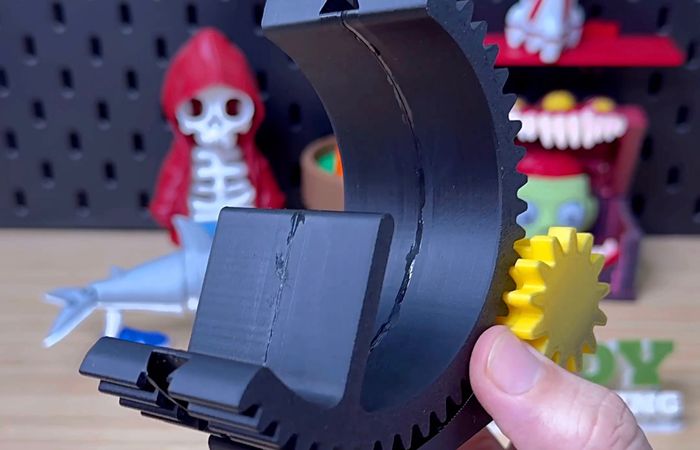

The stand allowing you to comfortably and securely hold your mobile phone at the optimal viewing angle.
  • Designed for printing completely without supported!
  • You will need glue (Superglue for plastics). It is necessary to connect the parts (02_Gear_Stand_Left + 03_Gear_Stand_Right) together.
  • Its possible that the gap between the base and the tilt gear will be too large. This will cause a slip. To prevent slipping, I recommend sticking the electrical tape on the guide (Base). Or you can also add a layer of glue on the contact surface and let glue dry.
  • Otherwise, if the connection is too rigid, it is necessary to grind the contact surface.
