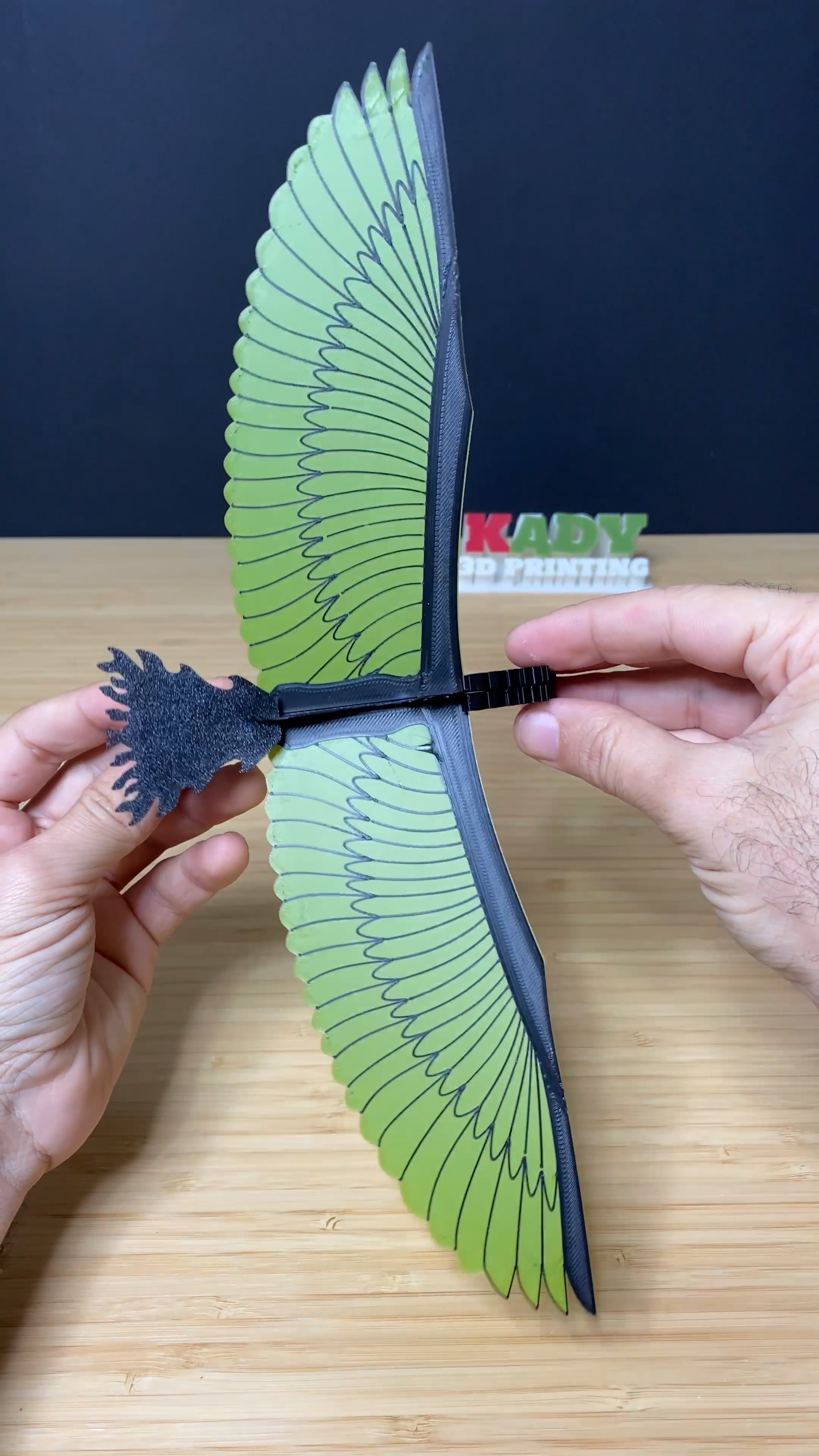

I printed this model at Prusa mk2, PLA, 0.2 mm layer, 0.6 mm nozzle. It is necessary to have good calibrated first layer. Body have to be printed with 100% infill for appropriate balast.
Flying
After printing, you need to bend the tail up a bit and you are ready to fly indoors.
